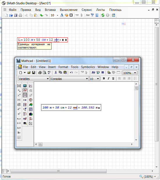

Why this not working?
#2 Posted: 7/11/2014 3:36:24 AM
127 likes in 342 posts.
because of caps?
[albumimg]354[/albumimg]
#3 Posted: 7/11/2014 3:42:26 AM
1,558 likes in 1,868 posts.
I use russian units. They do not work. I don't know is this a bug or not. English units are working fine.

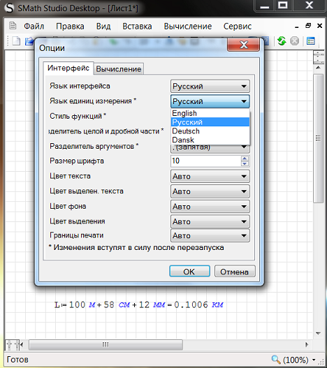

Thank you Radovan, now it works fine (default was English.).
