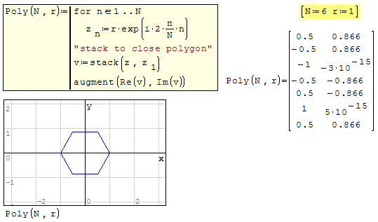

#1 Posted: 8/7/2017 9:01:29 AM
Maths Polygon.sm (8.43 KiB) downloaded 1394 time(s).
Davide Carpi 8/7/2017 6:42:00 PM
#2 Posted: 8/7/2017 9:35:25 AM
... revised for automated additional plot points.
It will create the required file system.
Maths Polygon.sm (15.86 KiB) downloaded 1389 time(s).
#3 Posted: 8/7/2017 9:40:30 AM
... that one !
Maths Polygon.sm (13.14 KiB) downloaded 1417 time(s).
