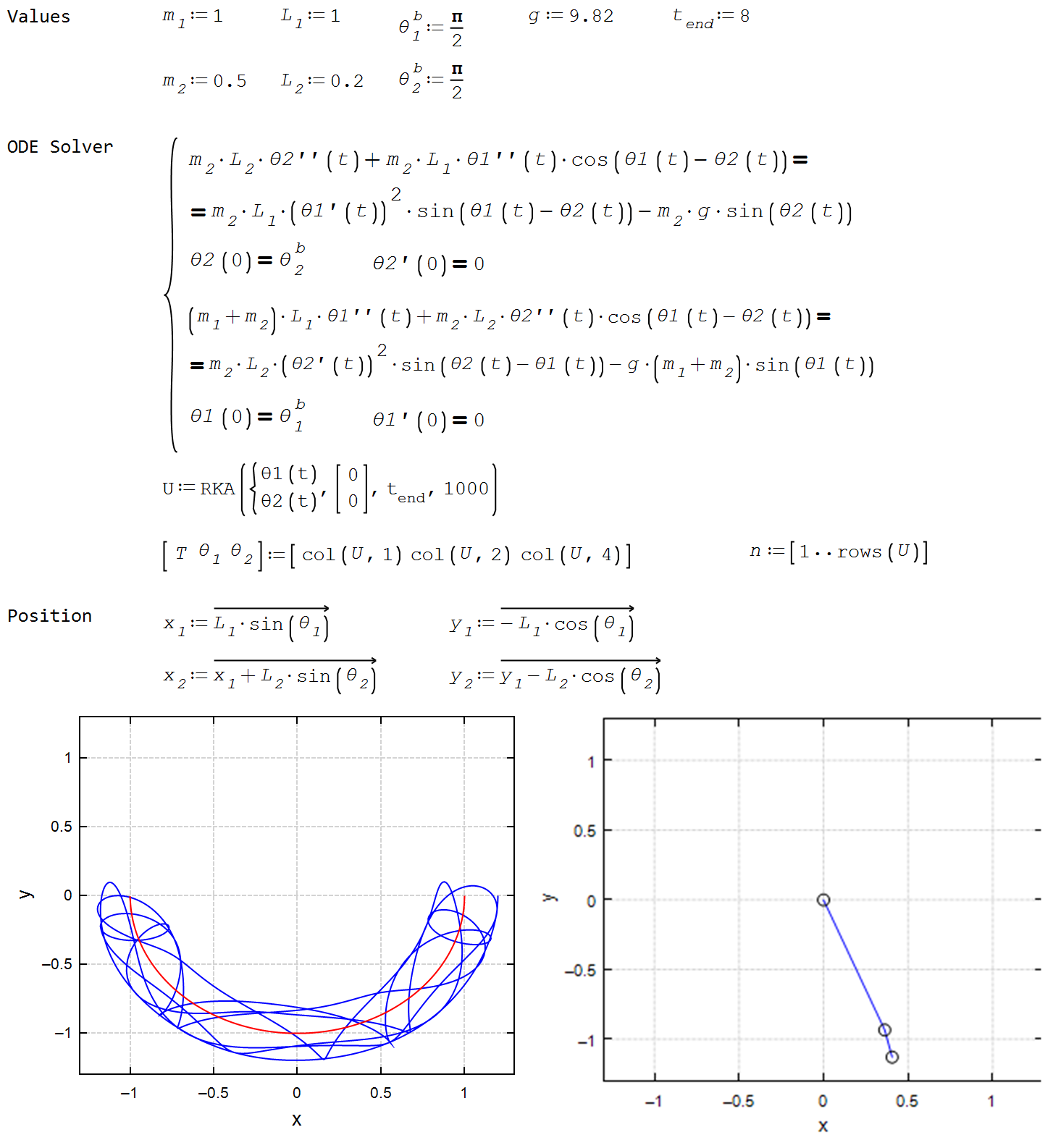

I feel the model is not correct - help please!

Hi Valery. The system is coupled. This is a way to solve it.

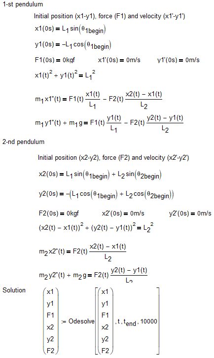

#3 Posted: 9/21/2026 2:02:10 PM
Yes, that is correct; I previously reported on the limitations regarding the systems.
The algorithm does not currently classify the task, so issues may arise with complex problems that the current method cannot solve. It might produce a plausible-looking solution that does not actually address the problem at hand.

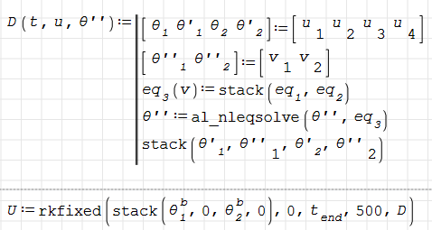

#5 Posted: 9/22/2026 10:43:08 AM
If mathematics is a tautology, then life must be one too. That joke reminds me of the one a plant process engineer played on me when I went to get the bourdon gauge I was supposed to install. Without a word, he handed me a brown box. That was when I have the bad idea of asking what was inside. His answer was that it contained a mechanical device that measures fluid pressure using a curved, flattened metal tube that straightens as internal pressure increases, driving an indicator needle across a calibrated dial.
The RKA function includes the necessary procedures to solve hard coupled systems.
double_pendulum_RKA.pdf (483.53 KiB) downloaded 261 time(s).
double_pendulum_RKA.sm (43.57 KiB) downloaded 326 time(s).

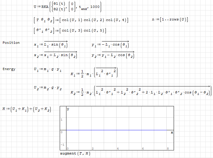

Thanks, Alvaro!
But I cannnot create five f(t) plots:
Potential energy of pendulum #1
Kynetic energy of pendulum #1
Potential energy of pendulum #2
Kynetic energy of pendulum #2
Sum of energies for the verify the model and ODEs solver. Must be const.
Help please!
Help please!
Edited 10/8/2026 11:18:52 AM
#7 Posted: 10/9/2026 1:06:49 AM
Hi Valery. This is a way. You can plot the time in T versus U, K or U+K. The plot in the figure shows that the energy is constant. In this case also, the total energy is the hamiltonian.
double_pendulum_RKA.sm (49.21 KiB) downloaded 185 time(s).

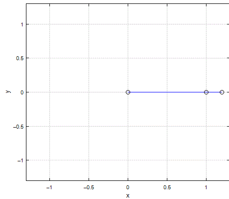

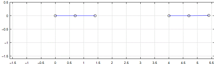

Butterfly_Effect_Example.pptx (999.46 KiB) downloaded 112 time(s).

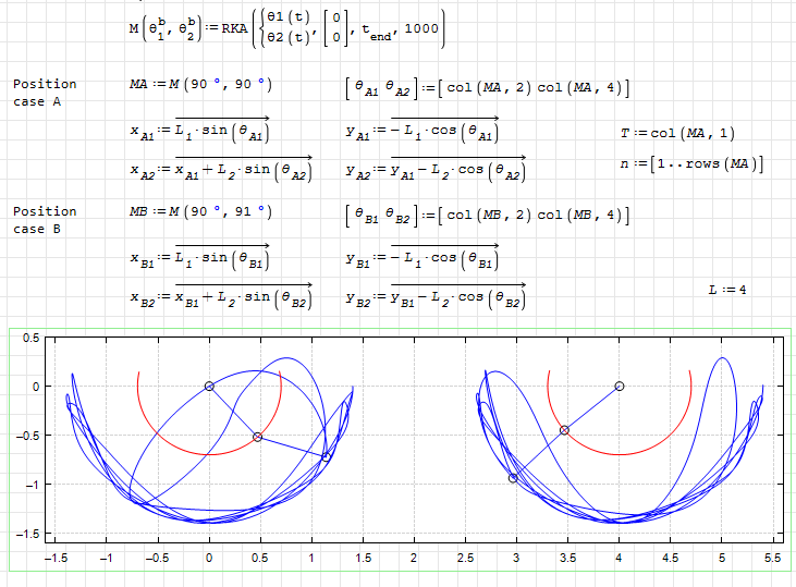

Hi Alvaro & Valery,
I enjoyed the matematical results of yours developements, without following all details.
I propose you a problem, dealing with the Butterfly Effect on a double pendulum - after some cycles, the 2 pendulums becoms distinct. Attached there is a simple gif file
Hi Alvaro & Valery,
#9 Posted: 10/10/2026 12:03:48 AM
Hi Ioan. Something like this.
double_pendulum_RKA Butterfly Effect.sm (50.58 KiB) downloaded 182 time(s).

#10 Posted: 10/10/2026 12:30:41 PM
Ooo it's wonderful!!!
My dumb explanation is that time delay generate between the 2 instances generate different precision in the solution graphics and hence the graphical difference (?).
Alvaro - All my thanks for your proverbial attention,
Have a nice WE,
Ioan
Have a nice WE,
Ioan
