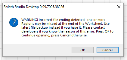

Related improvement introduced in build 7005: when SMath Studio detects similar errors it now shows the following message:
Program shows only available content if user presses OK.
frapuano 3/7/2019 6:29:00 PM
