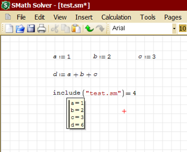

Given that include is capable of collecting all the names of the variables of a worksheet as the "whos" command of Matlab would do, perhaps the include code can be used to implement the option to delete all the variables with Clear( "all" ) or something similar.

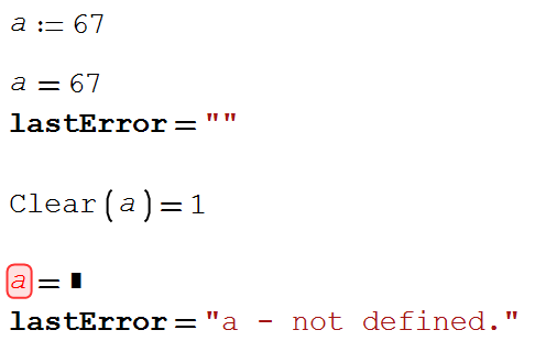

is there any function to remove all declared variables? similar to Clear
Clear(■,■,■,■,■) ...
clears the system in cause [variables, vectors, matrices]
Clear(x,y,z,m,ω)=1 are evaporated from the system.
Page17 Clear.sm (15.52 KiB) downloaded 1622 time(s).

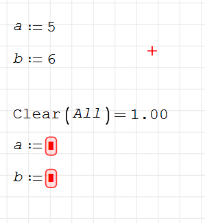

a:=5
b:=6
Clear(All):=1
a=?
b=?
Thanks for answers
BG

CustomFunctions plugin
direct link: link removed (now the extensions manager works again)
Oscar Campo 10/9/2023 7:38:00 AM, Arie 10/9/2023 10:58:00 AM, overlord 10/9/2023 6:20:00 PM
#18 Posted: 10/9/2023 6:23:22 PM
600 likes in 1,381 posts.
This works!!!
Thanks for the beta update.
What would you think about revising output string?
Instead of "1", it can be;
arg==1 --> "All cleared"
arg==2 --> "Variables cleared"
arg==3 --> "Functions cleared"
