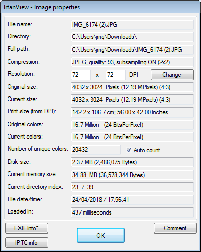

#7 Posted: 4/24/2018 7:07:52 PM
Any suggestions
Rather questions:
1. 2.5 MB for 4 simple arithmetic ?
2. What generates the gray background ?
3. Is that what it prints ? Visibility is around 7 % zoom down
4. Check the keyboard style as well.

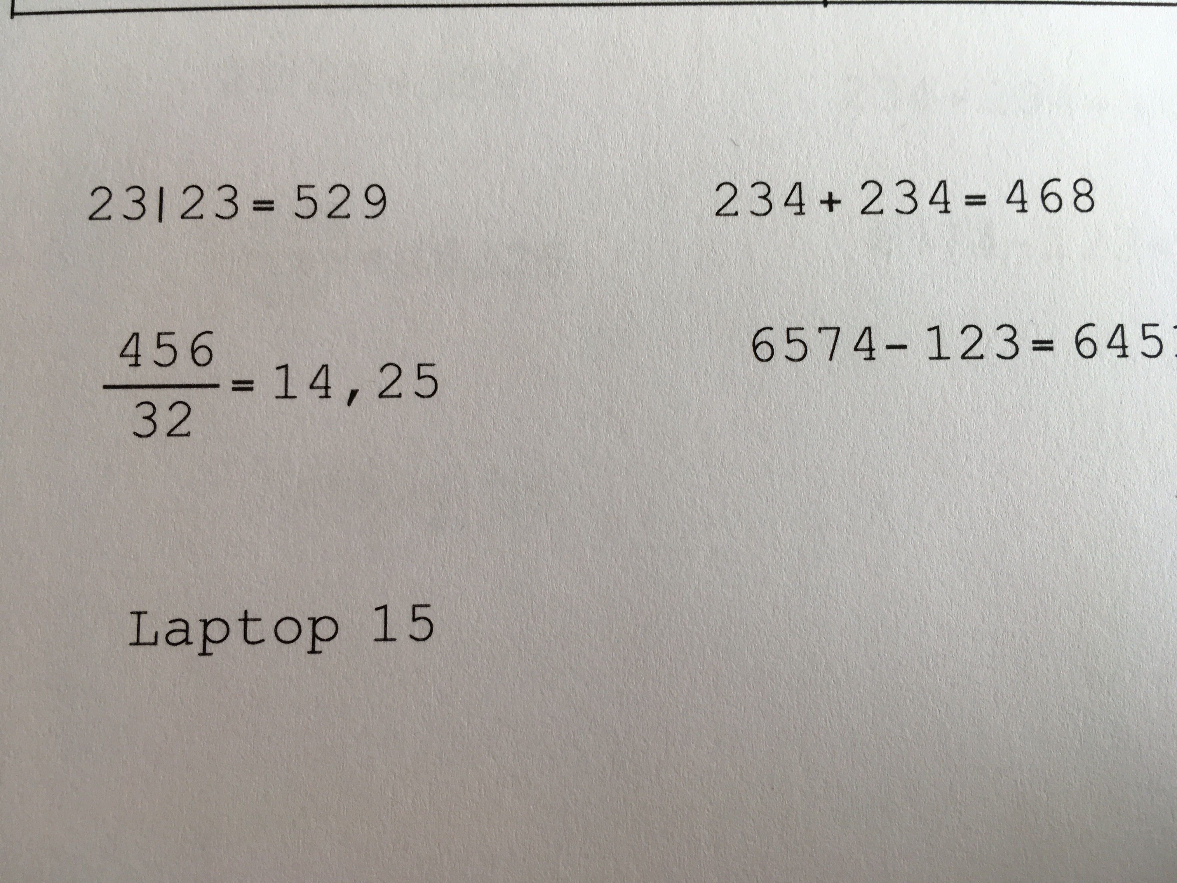

#10 Posted: 4/30/2018 7:53:57 AM
DirkOS
DirkOS
0 likes in 4 posts.
Any suggestions
Rather questions:
Sry for the unconvenience, i took a picture!
