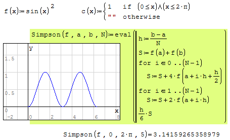

You may see more invented integrators, not to avail.
In short, this classroom is competitive to any other CAS.
You may retain 3 of them:
1. Finite Differences for noisy well populated data sets.
DO NOT smooth before applying FD. By "noisy" we mean as collected
rather than Quiz Noise having no project meaning.
2. Simplex is hyperfast, somewhat delicate to manage.
You can safely work on low range 's' [7 .. 11 typical]
3. ∫Adaptive(f,a,b,iter,TOL) universal Grand Champion
Thanks again Carlos for this competitor to all advanced CAS.
Enjoy, use wisely ... Jean
Integrate Compendium_24 Simplex-Adaptive Reconciliate Copy.sm (276.69 KiB) downloaded 1263 time(s).
