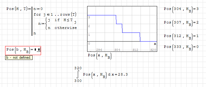

#2 Posted: 12/2/2016 2:34:57 PM
Hello [userlink]MarB[/userlink],
This is because when the numerical evaluation of a condition throws an error (if none of the previous conditions was true) or when the result of a true condition return an error, the function returns itself. When cases() returns itself, acts like a function not yet defined; this makes all his content active and evaluable, therefore when it fails n:j and break are both evaluated and you get the first value of j (3).
The solution is to put the assignments out of the cases(...)' arguments
![2016-12-02 18_08_24-SMath Studio - [cases_in_function.sm_].png](/en-US/files/Download/A3e3yd/2016-12-02-18_08_24-SMath-Studio---[cases_in_function.sm_].png)

Thanks Davide for your help.
I think I am smarter now.
The reason why I tried my supposed solution was, that I "copied" a Mathcad function where I used "return j" instead of "n:j break n" and there it worked fine.
The other reason is, that I thaugt: why test all members of the vector when I know early that I have found the reason.
But this only to be mentioned by the way.
Jean, thanks for your help, too.
The reason for choosing a loop is that the count of the vector my vary and therefore nesting if/else is not practible.

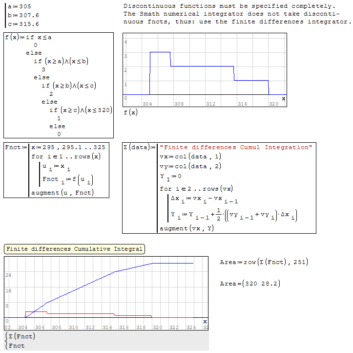

#6 Posted: 12/2/2016 9:01:03 PM
Whatever the "if/else" is presented to the user, the nested form
is computable in any number of loops and any size. The attached
example demonstrates a typical loop as it will appear in modern
"Programmable Logic Controller". From visible small sizes to
infinitely large sizes [very large sizes] system for controlling
industrial plants. As you can observe, the "nested" is essentially
based on the user 'recipe'.
The recursive construction belongs to the "logic ToolBox" as well
as the Bolean [not attached].
Integrate Discontinuous [Algo if].sm (52.51 KiB) downloaded 917 time(s).

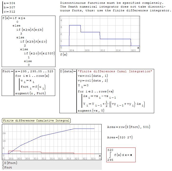

#7 Posted: 12/3/2016 12:21:25 AM
... same document but the recursive section deleted.
There is "shadow in the context".
Integrate Discontinuous [Algo if].sm (34.11 KiB) downloaded 915 time(s).
