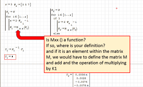

WroteI wonder why left matrix give error and right is ok?
They are identical, but the left one is incompletely dressed.
I don't understand the project. There is nothing more confusing
than subscripts. They are useful if the subscript is a long explicative definition.
Test1(1).sm (59.42 KiB) downloaded 1314 time(s).

WroteI think some definitions are missing
No, it's the operator formatting of the built-in minor() function. Can be found on the Matrix palette.

Seems some issue in the symbolic engine about the inversion of minor() when there are units
Because the right one comes from an if/else, that force a numerical optimization context while in the left case it's in a symbolic context.
To figure out the difference between K.1 and K.2, look at their content
![2018-03-09 09_33_13-SMath Studio - [Test1.sm_].png](/en-US/files/Download/qnPhmT/2018-03-09-09_33_13-SMath-Studio---[Test1.sm_].png)
- add a breakpoint on Mxx and look what it happens inside the loop in the 2 cases
- alternatively write on the canvas K.1= and K.2= with "none" optimization
