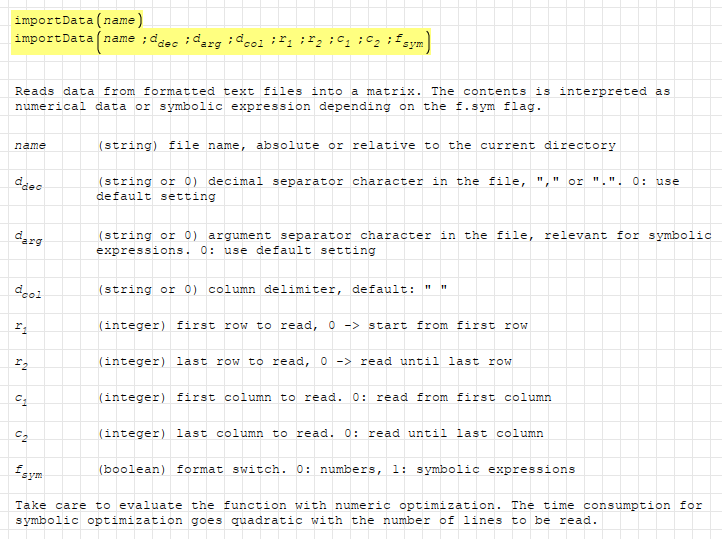

#2 Posted: 6/17/2021 1:49:55 PM
598 likes in 1,380 posts.
is it possible to import a file in txt to the smath and organize it by columns and rows???
If you mean a comma separated file (csv), yes it is possible with importData().

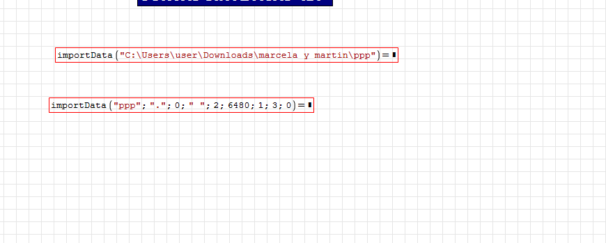

#3 Posted: 6/17/2021 3:39:09 PM
mnorena
mnorena
0 likes in 13 posts.
I allow your instrruccions, i dont know if i am doing ok, the name of the file is "ppp" and it shows me in the smath studio thats it is not reconized.

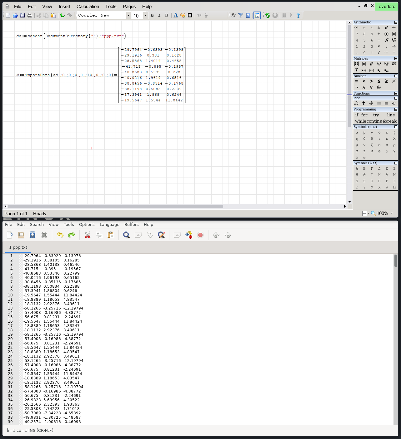

#6 Posted: 6/17/2021 4:27:20 PM
this it is the file, thanks for your help
ppp.txt (168.34 KiB) downloaded 1017 time(s).
You should write "ppp.txt" where you indicate your file.
You also just have to delete the first line from your data file.
It creates conflict between your function and data.
Data it provides don't match pattern of function.
So in result data can't be read.
Check below.
Show Spoiler
PS: martin is also right about getting partial data down below.

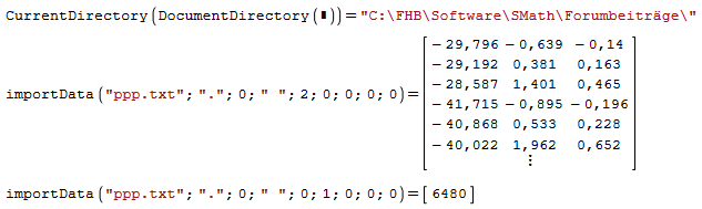

#7 Posted: 6/17/2021 5:12:18 PM
1,356 likes in 2,271 posts.
You can access differently formatted sections by reading them separately.
import.sm (4.81 KiB) downloaded 1080 time(s).
