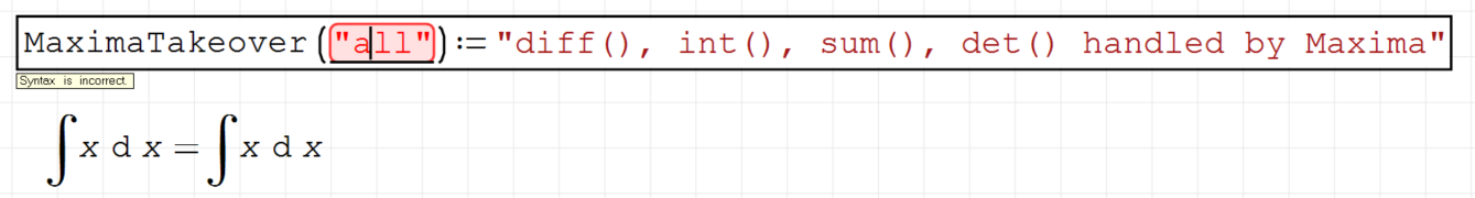

I am using Smath Studio with Maxima.
MaximaTakeover("all"):"diff(), int(), sum(), det() handled by Maxima"
But does not work when i insert int(x,x). Why?

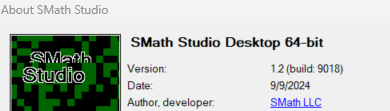

I am using this version of Smath:

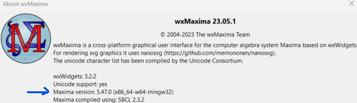

I am using this version of Maxima:

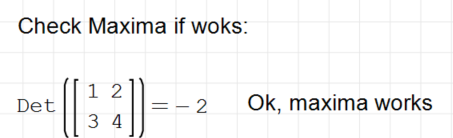

Check Maxima if works in Smath:

Ok, I saw where the mistake comes from.
I put definition sign := aflter MaximaTakeover():=, and should be evaluate numerically sign MaximaTakeover()=
Problem solved.
