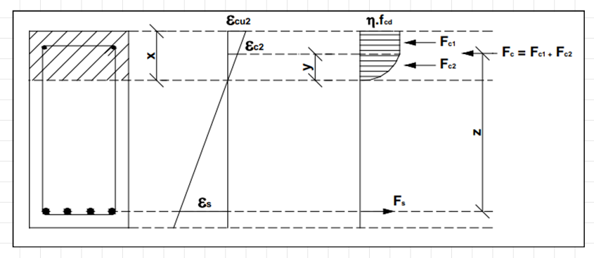

@StvMath:
As you said, you hadn't understood the Joao's problem:
It is a classical reinforced concrete bending resistance for a rectangular section:
![2024-03-18 15_48_08-SMath Solver - [Tentativa de NewtonRaphson_2 (1).sm].png](/en-US/files/Download/rDNdpr/2024-03-18-15_48_08-SMath-Solver---[Tentativa-de-NewtonRaphson_2-(1).sm].png)
With some theoretical and normative assumptions, there is only one unknown "x" and it can be obtained from the bending moments equilibrium equation. All the Joao's development is correct.
The non-linearity of the problem comes from the non-linear behavior of materials.
