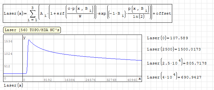

Here, I think the guilty is Smath "erf".
I would prefer be the guilty one.
Any collab is welcome to 'doctor' that one.
Scrap Laser.sm (41.31 KiB) downloaded 1069 time(s).
#2 Posted: 4/18/2016 2:28:13 PM
1,442 likes in 2,935 posts.
No issues I think,
the guilty is 1+erf()*exp() that should be (1+erf())*exp();
Let me know if there are other issues (erf is part of StatisticalTools)

#3 Posted: 4/18/2016 3:12:50 PM
Thanks Davide,
I just doctored it before reading you. Sorry for my distraction.

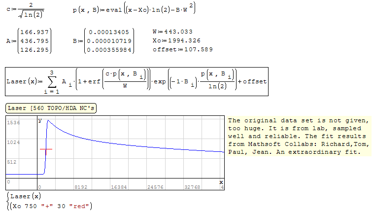

The "laser fit". Quite involved behind the scene.
