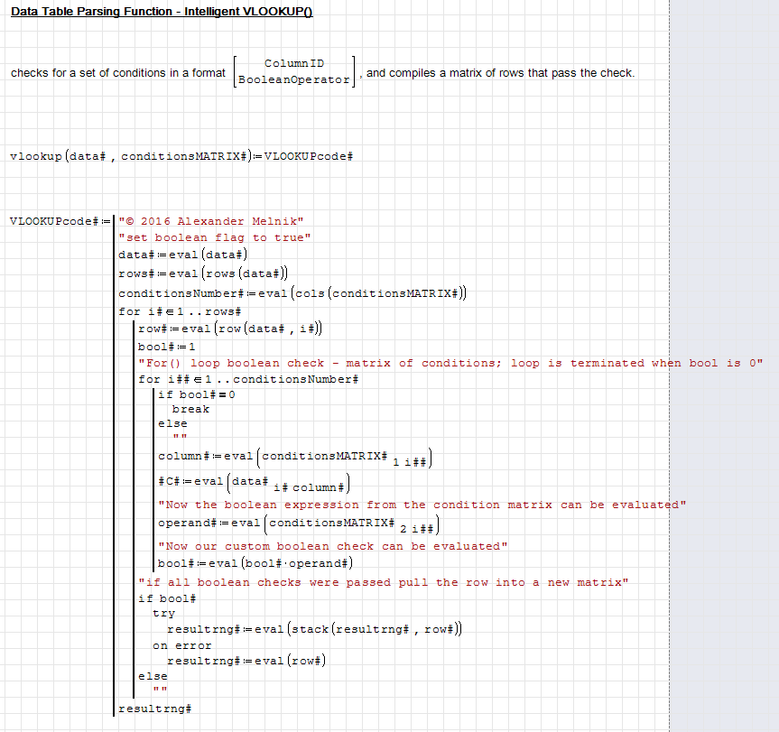

Data Table Parsing Function - Intelligent VLOOKUP() - Messages
VLOOKUPdataparse.sm (17.57 KiB) downloaded 1126 time(s).

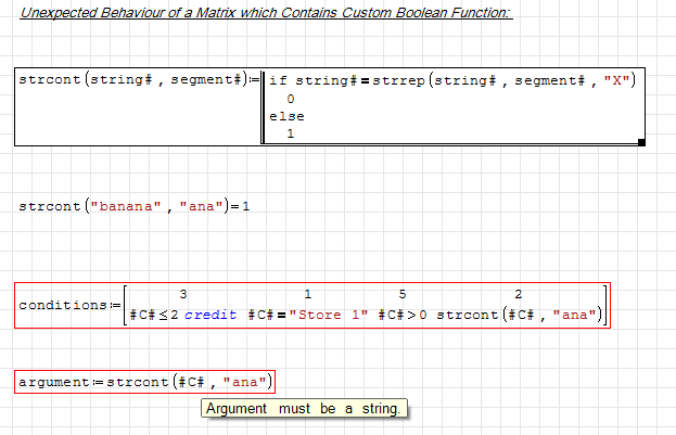

If an element of a defined matrix contains a user defined function with an undefined parameter it may inthrow an error similar to here (same SMath file as above):
I would expect the function with undefined parameter to return itself instead of giving an error code.
I think the issue comes out because there isn't a way to stop the preprocessing in user-defined functions when you pass an unknown (and an unknown is not a valid input).

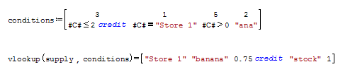

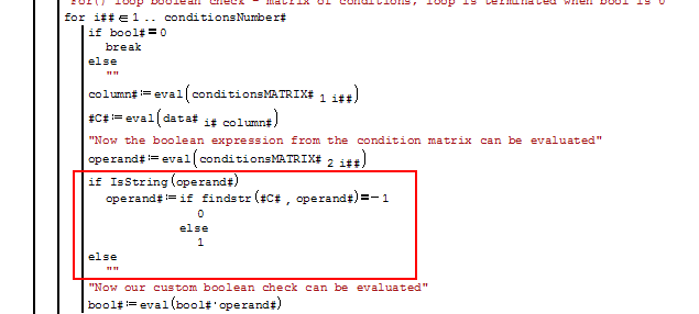

A workaround that might be useful even to avoid the use of other functions is to use a string as input in the second row, and a check in your lookup like this:
![2017-01-03 11_03_34-SMath Studio - [VLOOKUPdataparse.sm].png](/en-US/files/Download/mZTGB2/2017-01-03-11_03_34-SMath-Studio---[VLOOKUPdataparse.sm].png)
![2017-01-03 11_04_37-SMath Studio - [VLOOKUPdataparse.sm].png](/en-US/files/Download/6SQ5eq/2017-01-03-11_04_37-SMath-Studio---[VLOOKUPdataparse.sm].png)

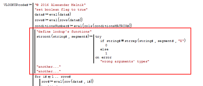

You can try with this:
![2017-01-03 16_36_25-SMath Studio - [VLOOKUPdataparse(1).sm_].png](/en-US/files/Download/H6Z6Eb/2017-01-03-16_36_25-SMath-Studio---[VLOOKUPdataparse(1).sm_].png)
strcont() is defined locally to avoid the preprocessing on the canvas
try() function is added because when you use el(...) inside the lookup function, all the elements of the condition matrix are evaluated -> you have to allow any type of input as first argument or let it fails silently (because strrep requires strings); note that if the selected element of the condition matrix is the one that contains strcon() with a wrong type as first argument, the error string will trigger an error on bool#:eval(bool#*operand#), because operand# will be a string.
