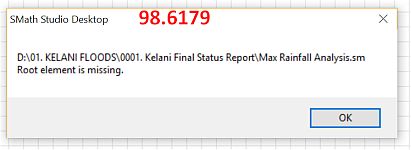

Attached SS file (98.6179) crashed and unable to recover.
Max Rainfall Analysis.sm (0 B) downloaded 1243 time(s).
#2 Posted: 1/9/2017 11:40:26 AM
"Root element missing"
Work sheet is empty: it was not saved most probably because some
character not allowed in the file name... why crashing Smath ?
Normally, Windows would issue a message telling "not allowed filename".
Can't help more: reconstruct from blank, simple work sheet name.
Any other failure of 6179 ?

I was making some minor changes to the working file.
When trying to select and move some assigned variables, then suddenly got the "usual warning that Smath does not respond".
When clicked to quit, got an option to save it and clicked to save.
The file closed, but then unable to reopen any more (showing the above error message).

Thank you for the report! I thought we have no such issues anymore...
To finally fix it I think SMath Studio should never immediately replace files on Save, but always create a new file next to existing one and replace old one with a new file only in case it was correctly saved.
Will implement this logic asap.
I hope you have a backup of this worksheet as there is no any possibility to restore it using a file you have attached.

Hi all, I seem to have the same issue. Tried to open my file the next day since the last time I worked on it but gave me error that "Root element is missing". Tried to use the Smath file recovery and it gives me error "Operation aborted: Not enough Data to recover or wrong file type". Filename is still the same as it always were, last thing I did on it when I worked on the file was adding a simple 2d plot, don't know if that might have caused it ?
Is there any way to recover the file since the last discussion on this topic? What is worrying me is that the file size changed to "0 kB" ...
