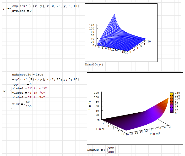

For my Physical Chemistry lectures I am adopting MathCAD 8th sheets attached to the Atkins and de Paula, 7th edition textbook, to the recent SMath Studio. For 3D plots I am applying plugin "3D Plot Region (Chart3DLib)" it works good except saving formatted plots. Have you got any idea how to resolve the problem.
The SMath sheet and PDF screen attached.

This is a version using the draw function of the Maxima plugin. The commands are described and demonstrated in Section 6.1 of the german SMath Handbuch
P701E02_Kr.sm (224.5 KiB) downloaded 1663 time(s).

Thanks Martin,
Now I have to overcome the "no maxima.bat" problem. .
Your solution allows rotation of the plot?
Dariusz
#4 Posted: 10/5/2020 1:24:49 PM
1,362 likes in 2,276 posts.
For configuring maxima, see the link in the signature.
The given solution controls the orientation by the view parameters.
Yet there is a so called Maxima Draw3D region, where interactive rotation is possible, at the price of slightly less stability (the region might freeze).
