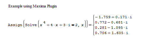

Hello, I want to solve a quartic polynomial with complex coefficients.. I tried "polyroots" function but it gives an error "cannot calculate",, Is there a plugin or a function that can solve a polynomial with complex coefficients in SMath? Thanks in advance
#2 Posted: 11/18/2023 7:02:58 PM
Oscar Campo
Oscar Campo
135 likes in 309 posts.
Here an example solved by using Maxima plugin:
best,
Oscar

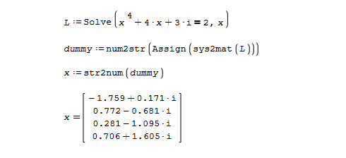

best,
Oscar
How to put these answers of Maxima plugin inside a vector?

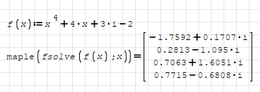

#5 Posted: 11/18/2023 8:18:30 PM
600 likes in 1,381 posts.
You can use maple() too.
Maple has a fsolve() function.
Which uses floating-point arithmetic.
ioan92 11/18/2023 11:28:00 PM, Oichi 11/18/2023 9:23:00 PM, Oscar Campo 11/18/2023 8:21:00 PM
#6 Posted: 11/18/2023 8:25:02 PM
Oscar Campo
Oscar Campo
A little trikiest
ioan92 11/18/2023 9:05:00 PM, Oichi 11/18/2023 9:23:00 PM
#7 Posted: 11/18/2023 9:23:58 PM
Oichi
Oichi
4 likes in 35 posts.
Okayy,,,The trick using num2str is so cool..
And thanks overlord, I didnt know about this maple one
