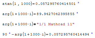

#3 Posted: 3/30/2020 2:02:58 PM

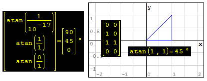

#6 Posted: 3/30/2020 6:22:03 PM

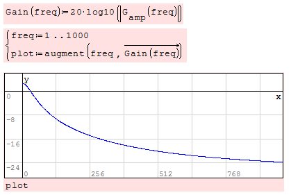

#11 Posted: 3/31/2020 10:14:39 PM
So this post of mine should go to someone who is either willing to jump into Zedgraph or create a similarly functioning plotting tool for Smath Studio. I am afraid to say that the standard Smath Studio plotting tool is a bear. It is very difficult to work with not being able to set it up as you wish and it completely lacks the logarithmic scaling functionality that an Electrical/Electronics Engineer would need as presented in my example.
In lot of instances Mathcad 2D plots is more immediate.
Many of my 2D Smath are far superior for publishing.
log-log Bode plots is even more attractive than Mathcad.
I lost patience on that, not being my cup of tea !
No recollection who is the artisan of that one.
Cheers, welcome to Smath Community ... Jean.
2DPlots ZedGraph log-log.sm (100.84 KiB) downloaded 1571 time(s).
