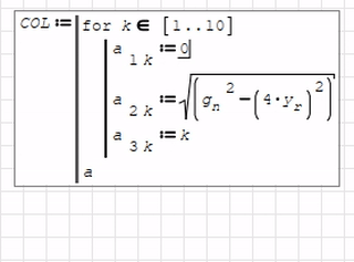

hi can anybody please explain why the following does not work, and how I need to change it.............
many thanks
#2 Posted: 5/24/2021 7:19:39 PM
600 likes in 1,381 posts.
many thanks
No problem here. You have misspelled the function.
The equality for 3*4 or 4*k is next to matrix element.
It has to be next to matrix, whole of it.
COL_FOR.sm (4.49 KiB) downloaded 1280 time(s).

Thank you "overlord"..............what a basic error, I feel stupid, must need new spectacles. hehe.

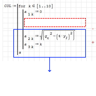

Folks, I have another query please and am grateful for help.
As per diagram below, how do I move several lines down and create space for another equation inside my "for" loop.
#7 Posted: 5/25/2021 8:22:23 PM
Use your arguments separator for this.
This works also for vectors but not for matrices.

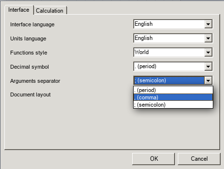

thank you, but can you please clarify what exactly is the "arguments separator" ?
#10 Posted: 5/25/2021 9:12:44 PM
It depends on your setting.
Its setting is under Tools > Options.
I use semicolon, default is comma I guess.

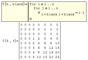

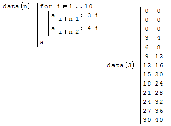

#11 Posted: 5/25/2021 9:22:37 PM
how do I move several lines/cols down/right and create space
#12 Posted: 5/25/2021 9:33:27 PM
Page12 Ravel Matrix.sm (9.46 KiB) downloaded 1409 time(s).

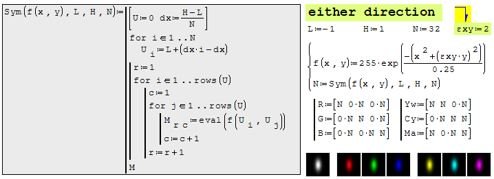

#14 Posted: 5/26/2021 8:07:15 PM
This is like Schrodinger's answer, both right and wrong at the same time, lol.
I greatly admire that you have recognized
the long functional romance was Shrodinger lol !
Otherwise coded from Mathcad ODEsolve .
Maths Schrodinger.sm (67.54 KiB) downloaded 1204 time(s).
