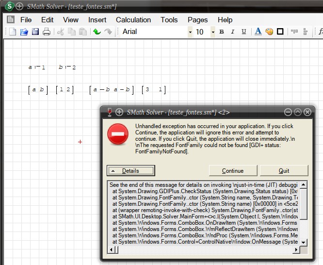

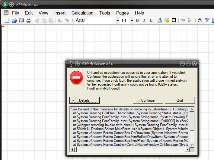

I don't know if someone has seen this before but I'm having problems with SMathStudio showing assign/evaluate (:=,=) and math operators (+,-) as shown below:
does anyone have an idea of what is going on?
I'm using OpenSuse, SMathStudio (Windows version with wine, but it also happens with the Mono version as well), latest stable/beta versions. It happens with new worksheets and with loaded worksheets.

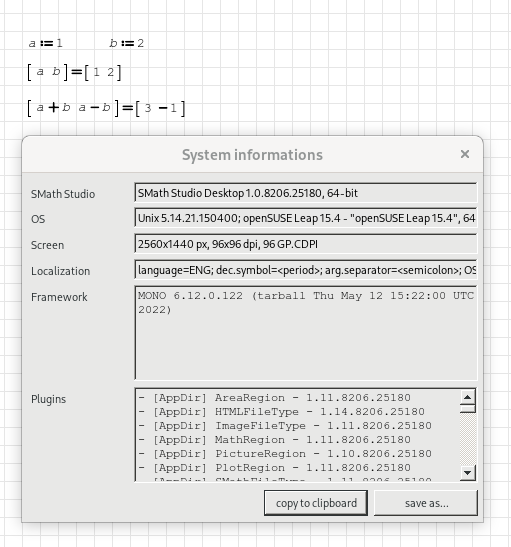

I have tried Smath with openSUSE_leap_15.4_live iso.
Seems everything is fine and working as it should be.
At first I tried with appimage I created. It is v0.99.7822 and it worked flawless.
Then I have installed mono-complete and downloaded latest v1.0.8206.
And there was no issue with it either, no problem with symbols or anything else.
Can't help you further from here without additional information.
