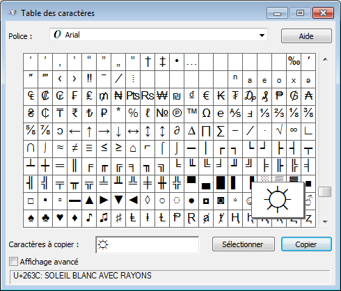

Hi IAks,
You don't need a plugin, just the right Unicode character (you can copy and paste the character from one site like Wikipedia, tamasoft.co.jp, alanwood.net or you can add the character holding the U and typing a #CODE# from the numpad)

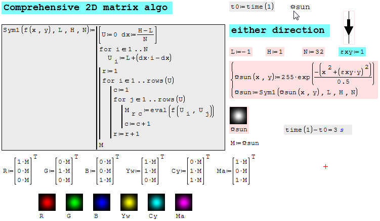

Hi. You can use this for not leave SMath and get the unicode chars that you want:
UNICODE_VAR.sm (2.45 KiB) downloaded 1271 time(s).
Notice that you must to split the unicode char for preventing it substitution with the char itself when copy and paste the expression.

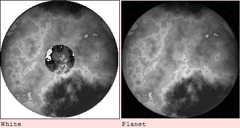

WroteIn astronomy I need to use a symbol that looks like a circle with a dot in the middle as a subscript
... from 6 years old .
Tentatively we can highlight a specific circular region.
The attached were left unfinished.
Image Planet Luminosity_1.sm (100.57 KiB) downloaded 1270 time(s).
Image Planet c(planet)planet.sm (79.22 KiB) downloaded 1267 time(s).
Image Planet fmap.sm (183.45 KiB) downloaded 1288 time(s).
Image Planet Luminosity.sm (219.14 KiB) downloaded 1223 time(s).
Image Planet Luminosity_2.sm (236.04 KiB) downloaded 1250 time(s).
Image Planet Gamma.sm (315.73 KiB) downloaded 1297 time(s).
