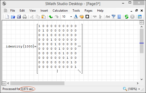

- Look and behavior of changing visible elements for output matrix significantly improved;

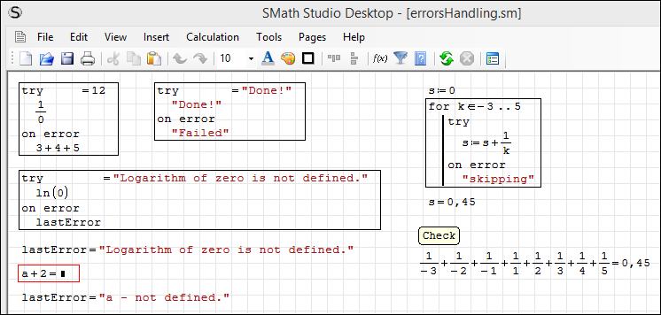

- Math Region performance improved in case of large expressions to be shown;
- SS-6: Region's error status cleared on description change for custom regions;
- SS-2312: Critical errors on pressing buttons from palette when cursor is in text entry inside the math equation;
- SS-2314: Function try(..) implemented;

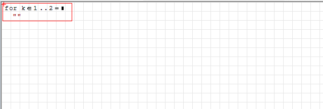

I can create new descriptions, but cannot edit existing - it throws an exception.

#4 Posted: 4/16/2016 8:59:52 AM
No problem - that's what nightlies are for.
Other problem: error description (and lastError) seem to be in OS language, regardless of SMath UI language.
E.g., in my Russian Win10, SMath UI is set to English, but for an erroneous block, I get error text "В экземпляре объекта не задана ссылка на объект.".
С уважением,
Михаил Каганский

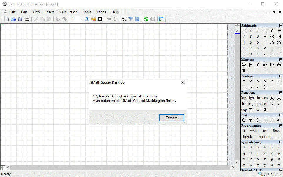

#8 Posted: 4/16/2016 4:31:16 PM
Smath Studio 0.98.5950 creates "MathRegion.finish" error for several worksheets of mine and files couldn't be opened. Same files have no error at version 0.98.5932 and perfectly opened. I have uninstalled 5950 and installed 5932 with same plugins and there were no problems at all.
As far as I witnessed I can open ".sm" files partially by disabling the plugins. The problems for my files are CheckboxList, ComboboxList, RadiobuttonList, WriterRegion plugins.
#9 Posted: 4/16/2016 9:21:33 PM
WroteThe problems for my files are CheckboxList, ComboboxList, RadiobuttonList, WriterRegion plugins.
I've updated these 4 regions for this SS version (many thanks to Andrey for the help via skype); let me know if you notice other issues.
P.S. WriterRegion is relased as Beta, it contains also several minor fixes not related with this SS update and a new option to choose when to popup the toolbar (Options > Environment). If all it works fine I'll relase these things also for previous versions of SS.
#10 Posted: 4/17/2016 12:20:20 AM
thank you for quick return, now it seems all plugins work as they are supposed to be.

I see that in 0.98.5951 the problems with descriptions and error string for my file had been addressed - thank you!
Here is another file with the same error string - just assignment added.
for-error.sm (1.8 KiB) downloaded 1742 time(s).

WroteHere is another file with the same error string - just assignment added.
Thank you! Will fix it.
