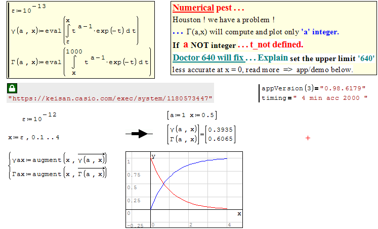

γ(a,x), Γ(a,x) ... read the document...
... mostly used in fitting data sets.

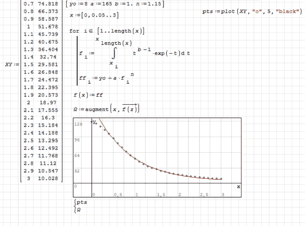

Playing a little test and error with the
coefficient y0, a, b, and n,
you get a better fit in the curve.
Maths Special Gamma(a,x)_Quick Copy_R2.sm (68 KiB) downloaded 1348 time(s).
Carlos

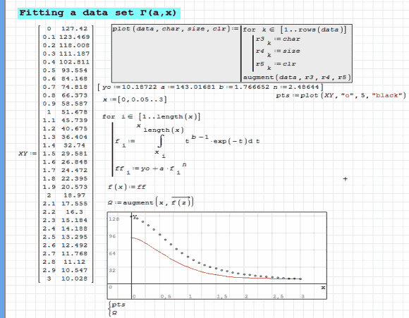

#4 Posted: 10/13/2018 4:24:36 PM
Thanks Carlos.
Here is an even better fit from your data reduction method.
Data reduction was introduced in the Mathcad DAEP [2003].
Kiby2 is stricking of realism ... attached.
More was done: linearisation of T/C [Thermocouple]
Genfit 000Carlos.sm (42.82 KiB) downloaded 1319 time(s).
Genfit Kirby_2 [Reduced].sm (75.33 KiB) downloaded 1089 time(s).
