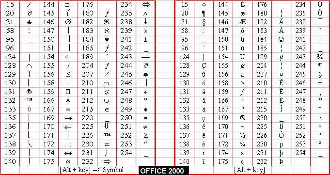

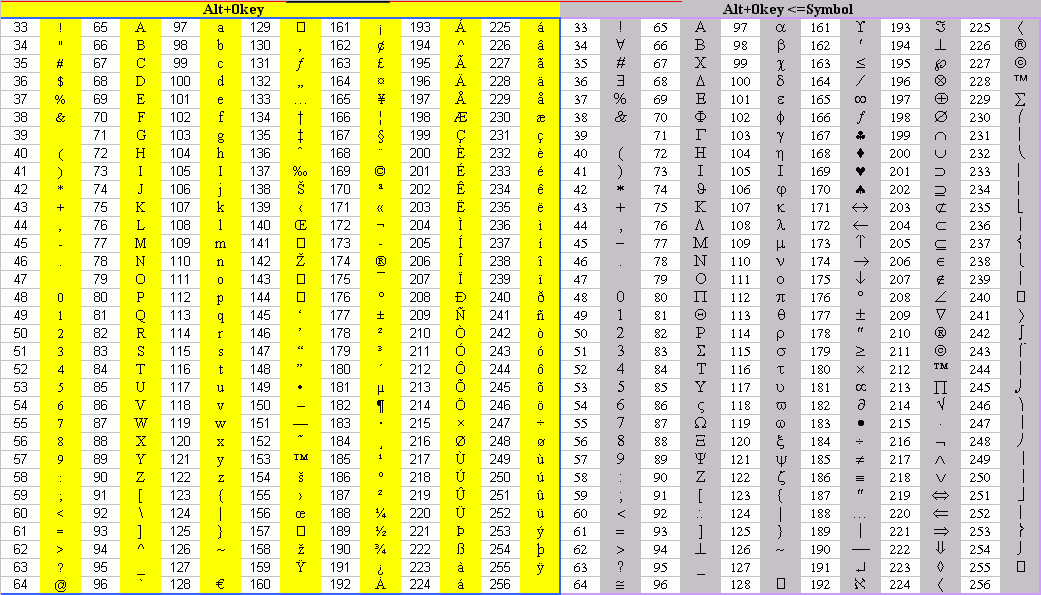

#11 Posted: 2/16/2016 11:42:04 AM
Smath recognises Alt+0key, but not Alt+0key symbol.
Smath does not have the "Font" plugin
Still very interesting for publishing.
