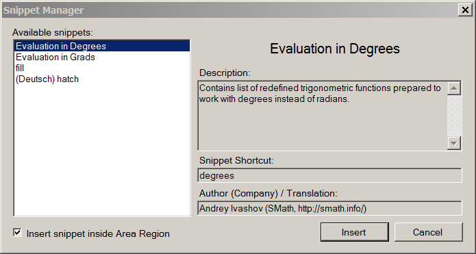

SMath Studio 0.90 will have a new interesting feature - Snippets. Here is one case how it works:
SMath Studio will have some built-in snippets, but of course every user can create its own snippets. Snippet in SMath Studio is a simple *.sm file that is placed into the special "snippets" folder. Every snippet can be inserted to the page using Dynamic Assistance (pressing TAB will insert snippet inside th collapsed Area Region; pressing Shift+TAB will insert just all snippet expressions without Area Region) or directly from the "Snippet Manager" of the "Tools" menu group.

#5 Posted: 6/1/2013 5:31:13 PM
Following Davide's recommendation, I supply the stuff as snippets with corresponding example. You may unpack the zip file in your SMath install directory, then the files go automatically to the correct locations.
Some remarks:
- The description in the snippet manager is taken from the file properties, this does not show up in the dynamic assistant.
- After insertion of the snippet, the dynamic assistant shows the the description text of defined functions along with their definition.
- The explanation text in the examples browser is taken from the file properties.
- The snippets are more of an exercise for me in making snippets and examples than a real contribution to the community, as they are quite trivial.
Also, I have not seen any set of snippets gaining such popularity that it is continuously discussed and improved like many of the great plugins. Feedback, however, is welcome. Perhaps, plotting related helper functions could be collected in a central example.

#7 Posted: 6/2/2013 8:14:19 AM
WroteThanks. The second plot takes like 20 secs to load, some english/german descriptions do not show up in the snippet manager.
English descriptions were incomplete, fixed. And, yes, the fill function is slow (no performance optimization done so far). I had the idea of making coloured contour plots using dots with computed colors, but given the lousy performance I think that is a bad idea. On top of that, most graphics tricks are obsolete as soon as any of the plugins under construction are mature and feature-rich enough. Matplotlib would be nice, but there is few hope as they have no c# api.
