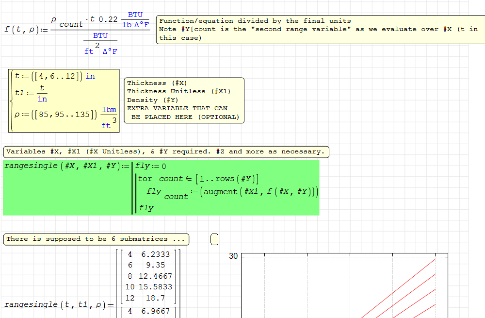

I need the following to output 4 as I'm trying to cancel out the units for a function using the variable.

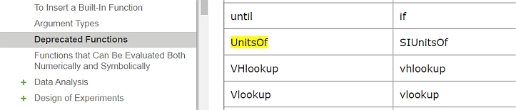

Hi. I think that SMath's UnitsOf() it's well defined, not like the equivalent in Mathcad, which it's deprecated
and substitute by SIUnitsOf(), even the Mathcad error was related with the default unit system setup (SI=MKS, FPS or CGS): https://support.ptc.com/help/mathcad/en/index.html#page/PTC_Mathcad_Help/example_explaining_SIUnitsOf.html

This is basic. I need to eliminate units based on itself. This is so I can use it on multiple equations with varying units within my functions
Jean,
I need the units for the formulas and as a double check. At the moment, I just created/defined a second variable (t1:=t/in in this case) to make it work.
Razonar,
Using UnitOf() as a variable, does not work. It divides out and changes the value as shown in the first post. I'm trying to eliminate having to define t1 (in this example) Heat Capacity Function1.sm (20.42 KiB) downloaded 1549 time(s).

Ruben Sidranski
Ruben Sidranski
17 likes in 465 posts.
Jean,
Your example is more detailed than mine, showing the same thing. In your case, you multiplied t by 39.37 for the conversion to inches. My intent was to "normalize" and just use the root variable to eliminate the units.
This appears to not be possible and I will just continue to define var1:=#var/units. The function is working on multiple equations, this would have been the "cherry on top".

Jean,
Let's take a step back and look at the Heat Capacity sheet.
This is the one you could not open, so I'm posting the revised function below. In this example (you have your sheet to look at), I just want to eliminate the variable #X1 as all it is is the variable #X unitless. As mentioned above, I just "defined" #X1 as #X/units and we are fine. I am updating calculations to use this "generic" function for consistency. I was just hoping to eliminate having to define #X1 as a separate variable ...

Ruben Sidranski
Ruben Sidranski
The intent of this thread was to find a built in function to to eliminate the units (my misunderstanding of UnitsOF()). In your screenshot, you have a multiplier ... in this case, 39.37. This is what I'm trying to avoid for other equations that might be in BTU. or FT, or "widgets". Lets move on to bigger items. The simple fix is to define #X/units (t/in in this example).
