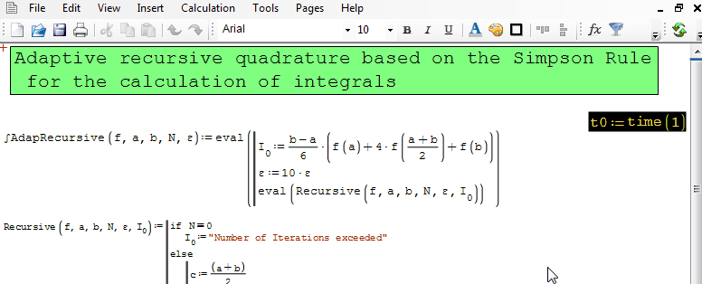

Here is an example of integration using the Simpson recursive adaptive method.
Adaptive_Recursive_Simpson_SS6179.sm (13.29 KiB) downloaded 1192 time(s).
On the other hand, when running the algorithm in the versions of Smath Studio 6179 and 7219,
I realize that the SS-6179 version is more accurate than the current SS-7219, since the
first one allows an error of 0.000000001, while the latter only allows an error of 0.000001
Adaptive_Recursive_Simpson_SS7219.sm (14.55 KiB) downloaded 1154 time(s).
The SS-7219 version cannot calculate the function with an error of less than 0.000001 to achieve greater accuracy.
Are we going back?
Carlos
