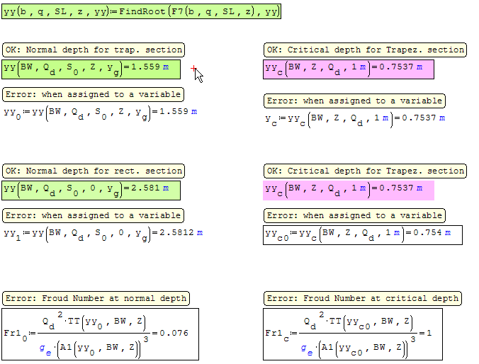

Now I observe that the result of FindRoot function unable to assign to a variable in attached SS file.
Test_FindRoot-1.sm (40.22 KiB) downloaded 1373 time(s).
Above file was extracted from the original file Channel Design-using FindRoot-R1.sm (206.01 KiB) downloaded 1388 time(s). for testing, but both had the same problem
under SS 0.98.5981. However, it was perfectly OK when I uploaded on 18th Oct. 2015 (cannot remember the SS version).
As Andrey has suggested, I did a clean installtion of SS, but the problem still exists.
Another isuue is also shown in the image.

Your worksheet will work in latest stable release 5935. The error you are facing is likely due http://smath.info/bts/Issues/IssueDetail.aspx?id=2318; I have a worksheet that is broken due to this and Andrey said he will fix it in the next nightly.

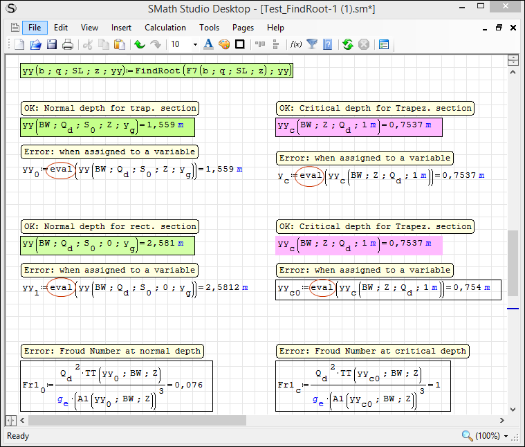

A working fix is to use line() in the function definition. Hope this helps Andrey to find a permanent fix.

I suggest to update plug-ins according to this comment: http://en.smath.info/forum/yaf_postsm33336_SMath-Studio-0-98-5973--09-May-2016.aspx#post33336

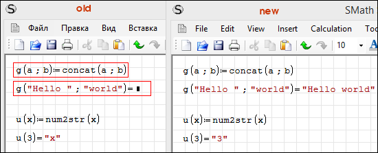

I you have to use not updated plug-in please give a chance to eval() function:
Why these changes are done:

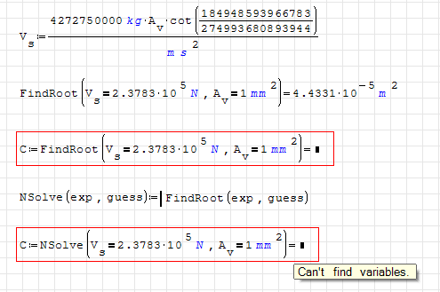

WroteCan someone please check this file?
BugFR.sm (6.15 KiB) downloaded 1441 time(s).
It still does not work with 0.98.5997 and updated non-linear solvers on my machine
Thanks!
It works as it should. You assign A.v in the first solution, thus in the second (C:...) there's nothing to solve. Use Clear(A.v) after the first to make it working the 2nd.
WroteThank you Andrey
Thanks!

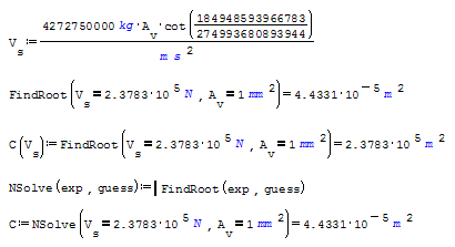

Thank you, I was not aware that FindRoot() automatically asssigns the result to a variable. I guess I was just stirring mud here..
Actually if this is correct this feature might be undesirable. What if you wooul like to solve a list of equations that have same variable? You will have to use "clear" every time...

Wrotewith Smath 5346 UNofficial release. No idea if it makes sense ?
I cannot reproduce neither with version 1.0999.5 of the plugin nor with later versions (strange). I suppose it may have sense, in some way, since undefined variables are store as names. However the second result is wrong, so something definitely goes wrong in that case :/
