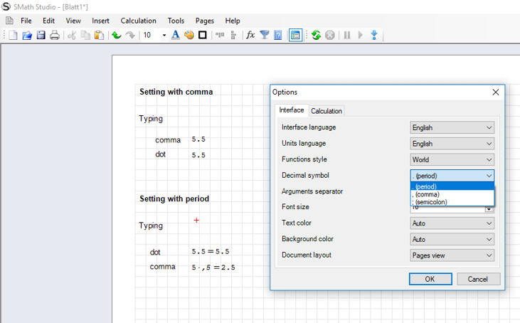

- while setting dot for comma, after typing comma a multiplication appears. Would be nice if, after typing comma here, the dot comma appears. In the opposite way it works.

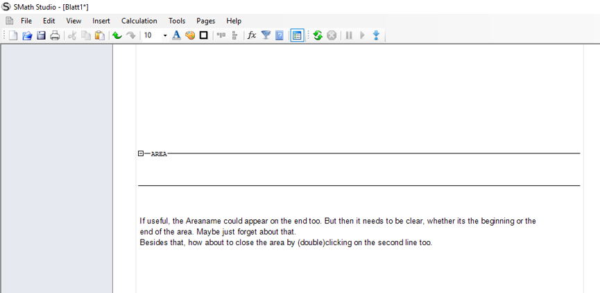

- the area name should also appear at the end of the area shouldnt it? And if I could close an area at the end of it too, that would be great.

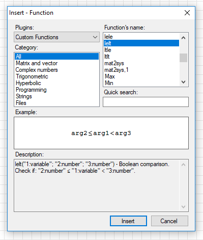

BTW, if neeeded, in Custom functions there is a set of functions that wraps ternary comparisons:

I should explain that with a picture.

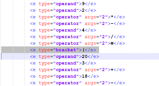

Hi. Or can hack the sm file deleting where "(" appears:
HackingEqual.sm (3.3 KiB) downloaded 1902 time(s).

Hi G-Tate. Difficult. I edit the sm file with a text editor and delete the "bracket" lines:
