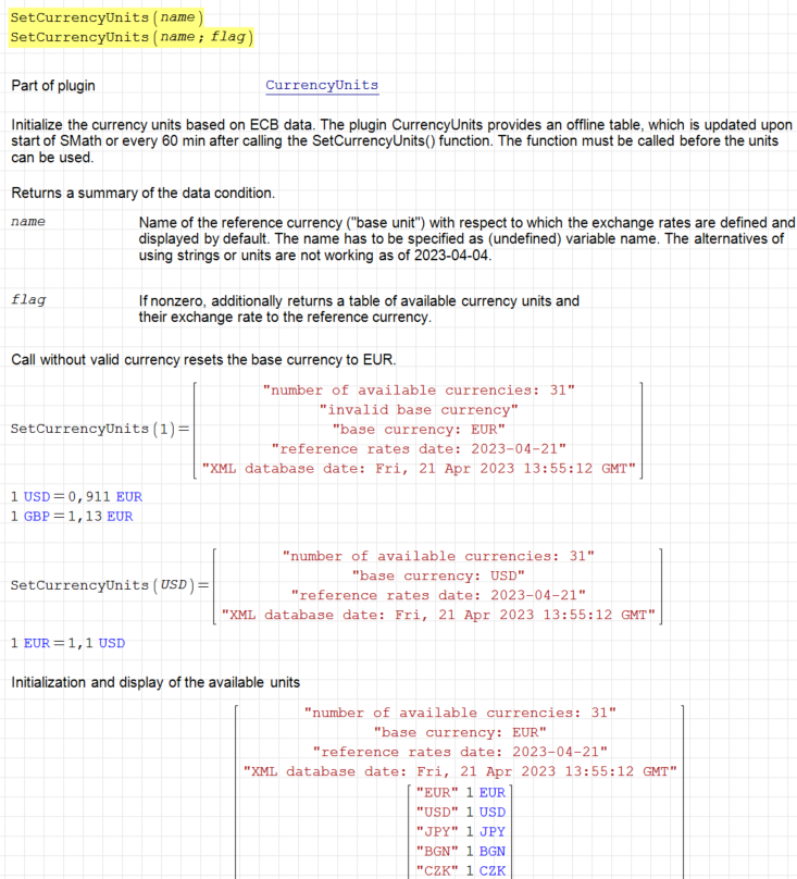

Here is an updated handbook page of the function SetCurrencyUnits().
In the current state, there seem to be some problems (filed as
Bugreport SS-4686:
- SetCurrencyUnits(2) doesn't display the exchange rates
- The base unit must be specified as an undefined variable name. Units (even not the units defined by the plugin) or strings don't work.
- Russian rubles (RUR) seem to be missing.
SetCurrencyUnits.sm (19.8 KiB) downloaded 1687 time(s).![2023-04-23 21_57_02-SMath Solver - [SetCurrencyUnits.sm].png](/en-US/files/Download/UnRUxV/2023-04-23-21_57_02-SMath-Solver---[SetCurrencyUnits.sm].png)
