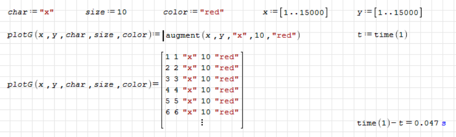

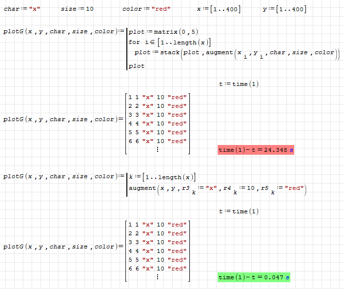

WroteFor such uses it would be good if the augment and stack functions could expand scalar arguments (or more generally any arguments not matching the maximum number of rows or cols) to uniformly populated vectors of the required size).
This is what I've got after improving stack/augment (see SMath Studio 0.99.6626):
Note, that I had to make height of the result matrix about 40 times larger to see the same time! This means that this syntax of stack/augment is about 40 times faster then without it.
Thank you!

WroteThis is what I've got after improving stack/augment (see SMath Studio 0.99.6626):
Looks great, not reproducible 6179.
Could it conflict in other situations ?
