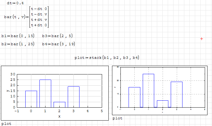

#3 Posted: 11/7/2016 3:51:00 PM
Just in case, might worth the effort to try with the modeller region
True
WroteAs far as I know there are no bar graphs in SMath.
True

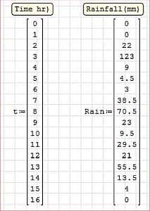

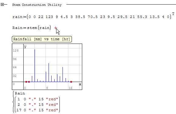

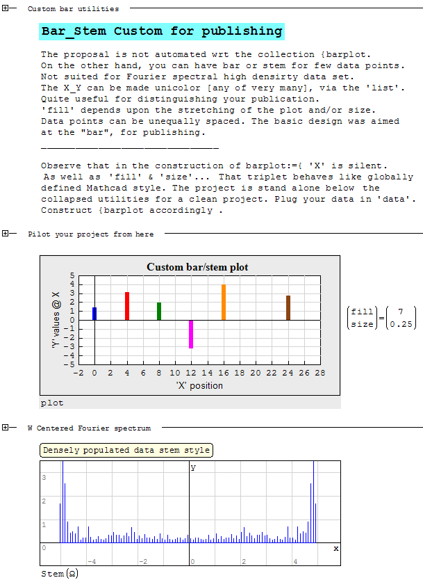

#7 Posted: 11/8/2016 12:23:45 AM
I know nothing about "Zedgraph".
I can se Davide had a "cat in the hat".
Stem plot does same/different in no time
except for the red 0 rain [<20 sec]
Cheers, Jean
Forum Rainfall.sm (87.7 KiB) downloaded 1348 time(s).
Cheers, Jean

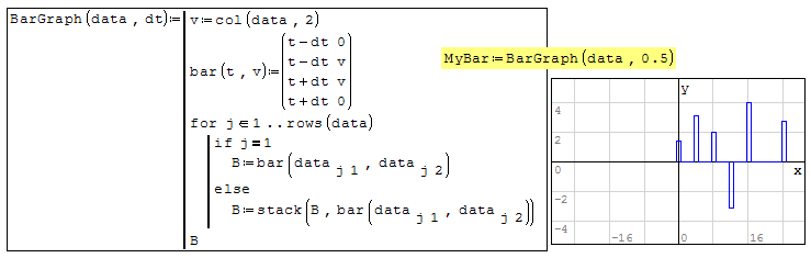

#8 Posted: 11/8/2016 2:47:45 AM
This scrap proposal makes me happy for some
distinctive small project. Manual but convenient
for small projects. For larger size and unicolor
the project needs be constructed around a counter.

#14 Posted: 11/8/2016 11:07:35 AM
In the Viacheslav proposal, you don't see bar not plotting equally wide.
Because the bars are so wide ! In the real project I proposed, the bars
are much thiner for dense project. Thus there will always be at least
"one" bar looking thiner because of the plot pixel impossible to match
perfectly along the stretching of the plot.
Cheers, Jean
Cheers, Jean

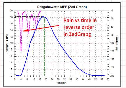

#15 Posted: 11/9/2016 7:26:03 AM
WroteSimple example
I used method proposed by Uni to plot Bar Graph to show rainfall in ZedGraph as shown (in reverse order).

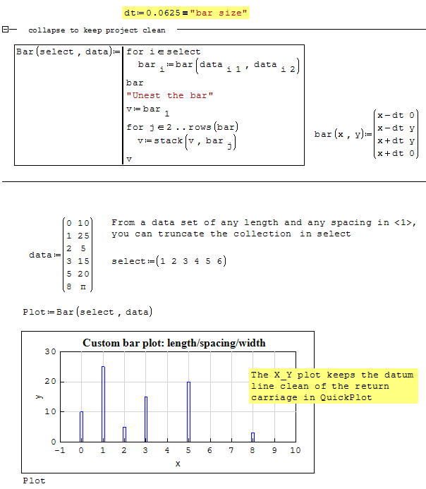

#16 Posted: 11/9/2016 11:54:21 AM
Thanks for the "Zed Graph" snippet. I don't have this plugin
whereas I will stay Smath 5346, and don't intend to upgrade.
The attached document is for publising projects.
Cheers, Jean
2D Bar Plot Custom.sm (35.01 KiB) downloaded 1315 time(s).
Cheers, Jean
