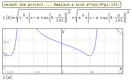

#2 Posted: 10/13/2019 6:23:01 PM
Oh ! ... your proposal is not much productive, is it ?
The picture is strictly discontinuous.
Reflection.sm (54.37 KiB) downloaded 1177 time(s).

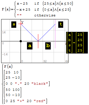

#5 Posted: 10/13/2019 11:00:11 PM
WroteWhat am I missing here ?
You are missing to plot the literal demo diagram,
here is as per your inputs [a,b,s,t].
More is missing from incomplete project description.
Reflection [abst].sm (62.14 KiB) downloaded 932 time(s).

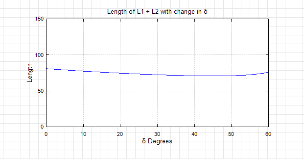

#7 Posted: 10/14/2019 11:46:04 AM
WroteI don't think L is discontinuous for ddegrees in the range 0 to 60.
L(ddegrees) should vary smoothly from L(0) to L(60)
Yes the length L is continuous with respect to ddegrees. I think Jean misunderstands the question. See attached. (A little sloppy but it works)
Edit: Updated graph to add labels
Edit2: Had an error in definition of L. Fixed.
Reflection_alyles.sm (177.77 KiB) downloaded 1197 time(s).
