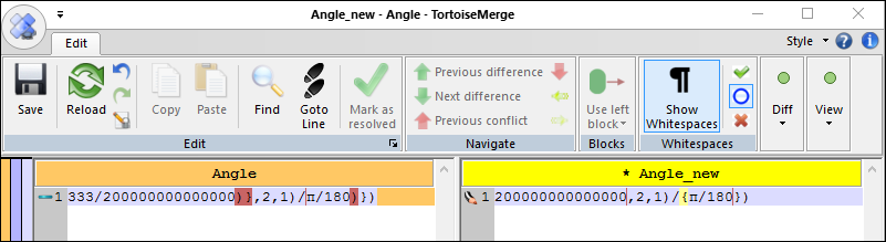

Error was found and now fixed in nightly build:

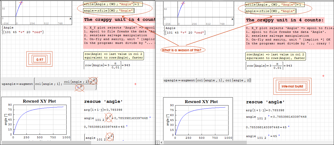

Please, could you comment about the reasons of rfile/wfile used?

Everything OK Smath 5346. The original code was incomplete for the X_Y plot.
No need to spool to file. Corrected code in the attached work heet 5346.
