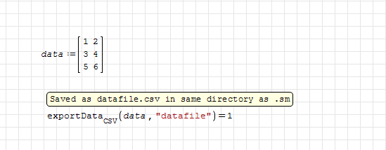

#2 Posted: 2/23/2019 8:38:47 PM
You can use the data exchange plugin. To install go to Tools->Plugins... -> Click (Local Storage) and select Online Gallery -> Look for "Data Exchange" -> Double Click to install.
A simple example of exporting to CSV is shown below. Note: you will need to save the .sm before exportData function will work.
csvExport.sm (2.81 KiB) downloaded 1098 time(s).

#4 Posted: 2/23/2019 9:39:04 PM
Alyles,
Thanks again. I discovered my issue. The = is a symbolic evaluation.
Thanks,
Reg
Thanks,
Reg
#5 Posted: 2/24/2019 10:02:43 AM
WroteThe = is a symbolic evaluation.
Not quite so ... =1 is logical answer "yes saved"
