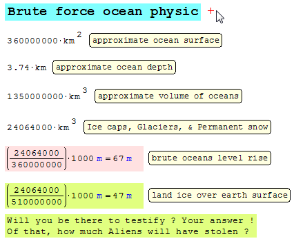

There more details not accounted.

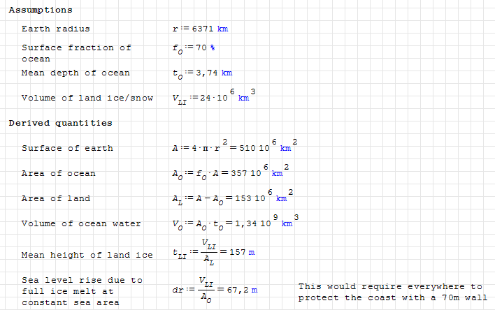

Use of units and variables -> more self documenting.
ocean.sm (10.02 KiB) downloaded 1145 time(s).
