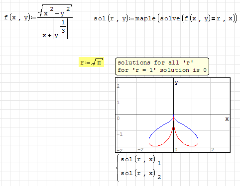

The limit of a function of two variables is the contour limit @ user value.
Maxima X_Y plots by default the 0 level contour. For other 'level(s)'
use the maple solve block.
#4 Posted: 2/22/2017 2:08:40 PM
What is a Maxima X_Y plot? Why would you need some solver for other levels if you can plot 0 level?
As I understand, the bivariate limit is a function of the x,y values and of the direction of approach.
It would be helpful to see what you expect to see (examples).

Wait for the f(x,y):=
X_Y plots contour of any level in the domain of existence w/o solver.
The solver is for discretising the export.

Wolfram is of no help as you can check by yourself: it is ill posed.
"the limit of functions of two variables ..."
read: implict f(x,y) have solutions wrt 'x' or 'y' alternately.

Wrotethis is just to know if it is possible from Smath using Maxima to handle limits of functions of 2 variables.
From the previous work sheets, answer is probably "NO"
Maxima will plot many implicit functions.
In the attached:
1. Valery Ochov "ImplicitFunctionGrapher"
2. an example of the CONTOUR matrix extractor
I presume I can exemplify the 'maple' RootOf,
Please, let me know.
Contour ImplicitFunctionGrapher.sm (28.2 KiB) downloaded 1228 time(s).
