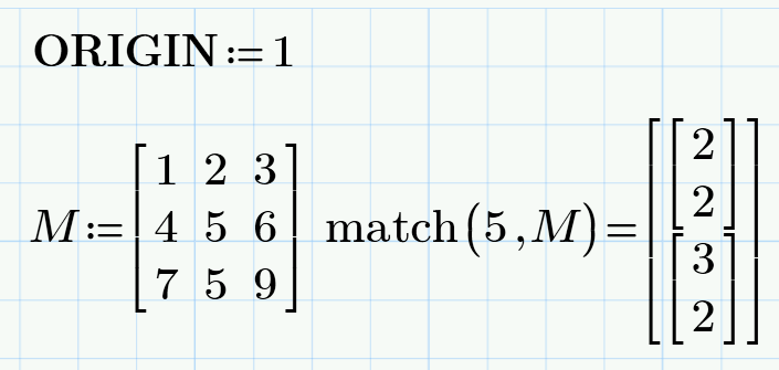

Hi
Is three the Mathcad-function match in SMath
#2 Posted: 10/17/2023 7:43:35 PM
In Solver 30405, we have a more advanced version ... last page.
Utilities Lookup TREASURY GOLD Copy.sm (498.21 KiB) downloaded 1284 time(s).
Valery Ochkov 10/17/2023 7:55:00 PM
#3 Posted: 10/17/2023 8:23:42 PM
Oscar Campo
Oscar Campo
135 likes in 309 posts.
Hi
You can check this post: https://en.smath.com/forum/yaf_postsm3742_lookup.aspx#post3742
Best,
Oscar
