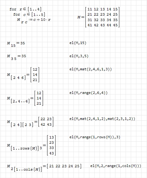

#8 Posted: 9/28/2021 4:21:01 PM
Hi. There are many different ways to access the elements of an array. This list is not exhaustive, and does not include the submatrix function.
M.sm (10.01 KiB) downloaded 1099 time(s).
#9 Posted: 9/30/2021 6:22:06 AM
Hay everybody.
Thank you so much, especially for the examples (Jean, Davide, Razonar). It brightened up a lot of problems for me regarding matrices. Once again, thank you very much. One more thing, how do you write the range of elements in an array? Regards Adam
