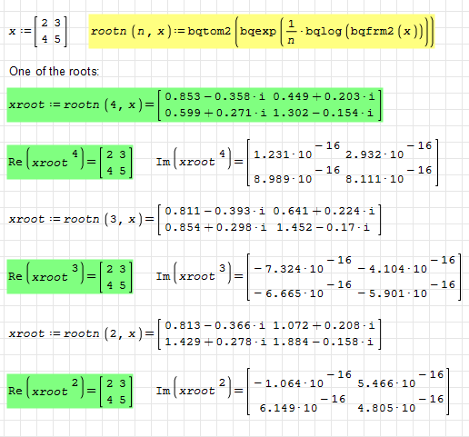

Based on bqmcadsrc.zip - bqmcad plugin for Mathcad from Evgeny Karataev.
The plugin uses Managed Extensibility Framework (MEF, .Net 4.0) technology to dynamically gather information about its functions. Can be used as an example to design your own solution.
