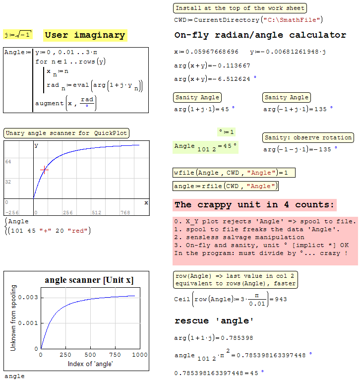

#3 Posted: 4/24/2016 8:40:06 PM
WroteHello,
I try to solve some problems in AC electric circuits.
Can I change the imaginary unit from i to j such that:
I enter data using j, and
output (from SMath) data using j?
Thanks,
Basile
This the 'PJ" version [PJ = Pyjama]
1. Define imaginary user style 'j'
2. Don't re-use 'j' as index.
3. No need to spool to file, but X_Y plot
does not take unit ° in "Angle" [Not defined].
I have removed previous posting and work sheets.
Cheers, Jean
Angle Data 'j'.sm (9.59 KiB) downloaded 1163 time(s).

#5 Posted: 4/25/2016 12:31:18 AM
... just watch the unit system in your Engineering projects.
Angle Data 'j'.sm (16.53 KiB) downloaded 1121 time(s).
