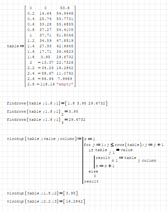

Hallo guys,
is there a similar function in smath for sverweis like in Mathcad or Excel?
Searching for a variable in a matrix and give back a certain number in that row?
Thank you br Stefan

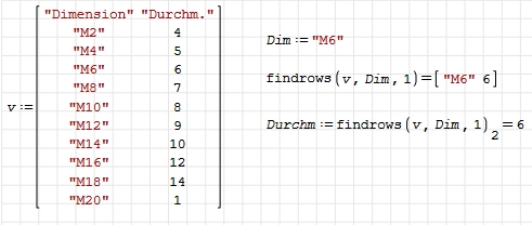

Hi. You have findrows in SMath

You can either use findrows() as Razonar mentioned.
Or you can use custom written vlookup() function uploaded before.
But I would stick with findrows() if I had to choose.
Worksheet1.sm (8.43 KiB) downloaded 1030 time(s).
