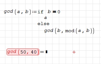

I'm not sure, but I think I might have found a bug:
I remember this used to work before. Am I doing something wrong?
error

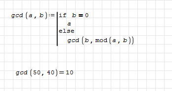

You need to use line operator in function definition.
Edit: A note about recursion. I do believe that Andrey limited the recursion depth that can take place. I think its somewhere around 50.

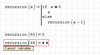

Example of recursion limit.
#4 Posted: 11/30/2022 2:11:53 PM
1,106 likes in 1,784 posts.
Hi. Every CAS should have a recursion limit. The point would be to be able to control it, like in Mathematica: https://reference.wolfram.com/language/ref/$RecursionLimit.html
Thanks!! How did I forget that. heh.

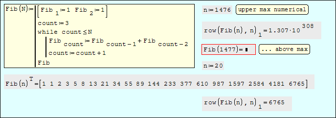

The Mathematica 4.0 Fibonacci recursion has Smath companion algo style.
That is not an example of recursion, that is an iterative method. Try googling something like "iterative vs recursive Fibonacci".

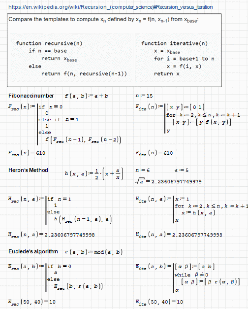

Either.
recursive_versus_iterative.sm (40.78 KiB) downloaded 1309 time(s).
