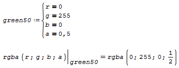

OK, one more try:
I wish to declare a color as green50 which is rgb green with 50% opacity.
green50:=(0,255,0,0.5)
and then use it (ie pass green50 as a variable) with Davide's rgba snippet:
rgba:=(green50)
Thanks in advance.

If you just want to store the input to rgba() in a separate variable and apply it later, then you might use the at() substitution function. Yet it is not clear to me, why one would do that instead of just storing the resulting color string from rgba()
Blatt5.sm (3.17 KiB) downloaded 1229 time(s).
Mark R Harris 11/20/2022 3:26:00 PM

Thank you Martin, excellent.
