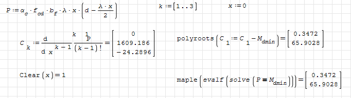

Good morning, I'm new to Smath Studio, I would like to know if it is possible to obtain the same result that was obtained in mathcad prime 6.0
math cad prime 6.0
https://i.ibb.co/S76VZZY/mathcad.png

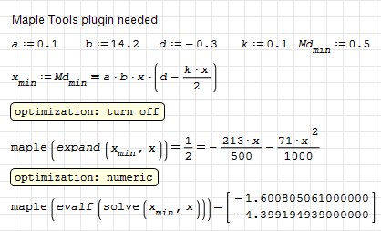

I need this display after the expand
https://ibb.co/Sfmj1jz
#7 Posted: 12/9/2021 1:07:56 PM
TIAGO C DOS SANTOS
TIAGO C DOS SANTOS
1 likes in 27 posts.
Hi Tiago. This is one way.
I need the blue rectangle to be the same as the yellow one, is this possible?
https://ibb.co/2n6Np5C
not the end result but what is between expand and solve
The polynomial coefficients?
#11 Posted: 12/9/2021 6:02:07 PM
TIAGO C DOS SANTOS
TIAGO C DOS SANTOS
#12 Posted: 12/9/2021 9:20:19 PM
If this is your doctrine ... superb !

sorry for my ignorance i didn't understand your answers, and because i need to show the students step by step how to perform the calculations
#14 Posted: 12/10/2021 8:22:24 AM
What construction/calculation step by step ?
#15 Posted: 12/10/2021 8:51:30 AM
TIAGO C DOS SANTOS
TIAGO C DOS SANTOS
#16 Posted: 12/10/2021 5:04:29 PM
598 likes in 1,379 posts.
Not possible to easily write all those functions in one line.
It can be done with serious alterations but shall not be practical.
I posted something similar to another user. But again, I wouldn't use it.
Just write functions and solves in multiple lines.
