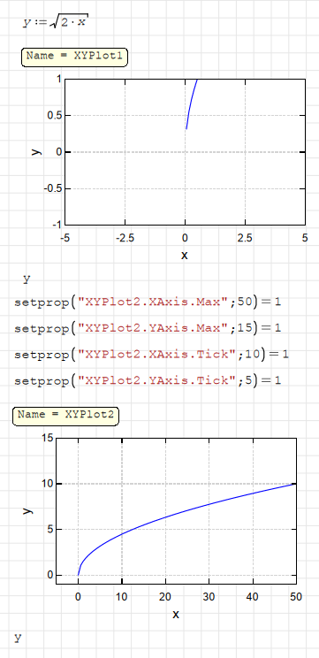

You can use XYPlot and setprop() function for that purpose.
Here is sample file for setprop function.
setprop.sm (21.36 KiB) downloaded 1662 time(s).

As a note: the 'name' of the graph (in this case XYPlot1 and XYPlot2) is specified via the XY-Plot Properties (i.e., double-click the graph to see the full list of properties); one of those fields is called "Name" which would be the title to reference the Plot through the 'setprop()' command.
