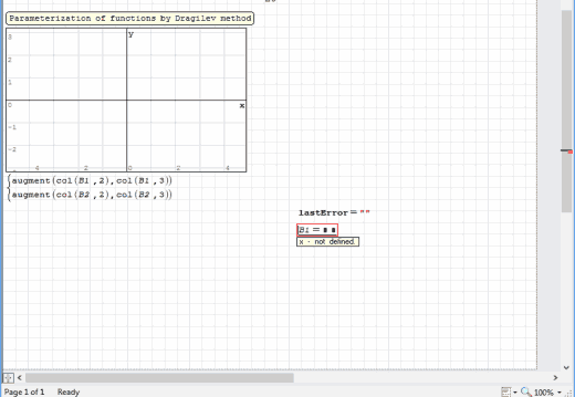

Hola Alvaro, Hello Ber7,
Thanks for your reply, but the DragilevMet2 and 3 files do not work.
The file of Ber 7 does not show any error, but by requiring the value
of B1 and B2, it says that "x" is not defined.
Attached drawing of the errors.

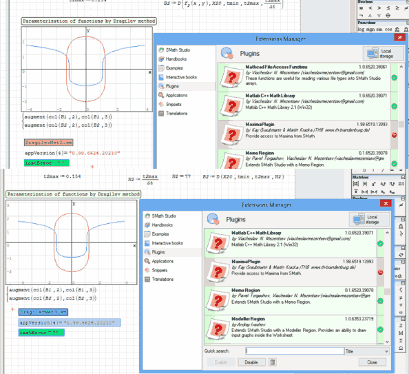

#14 Posted: 2/23/2018 3:56:57 PM
CBG
CBG
78 likes in 312 posts.
Hola Alvaro:
Gracias por tu respuesta.
Thanks for your answer, but I found the fault.
The interference is caused by the Maxima Plugin,
by disabling it, the file works correctly.
Carlos
