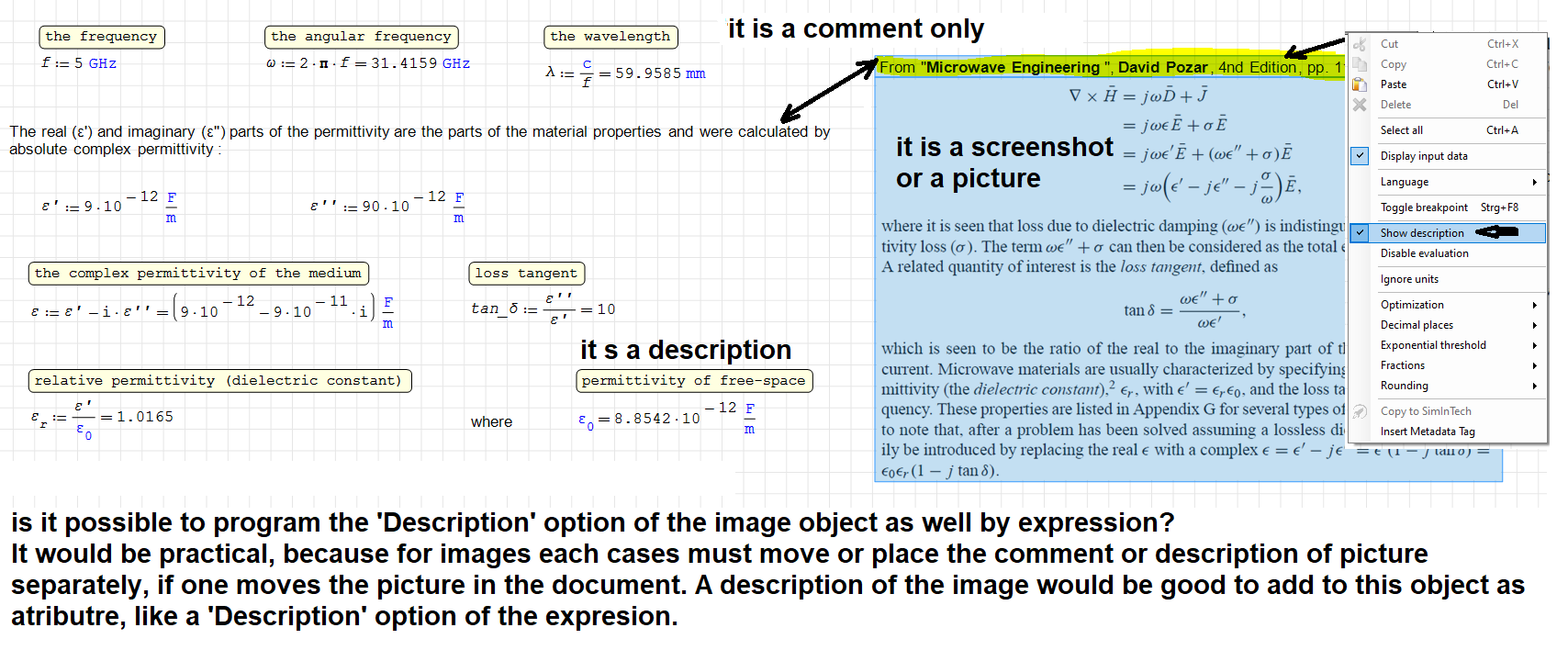

Hello dear Smath - developers,
I ahve a suggestion to option of the picture, that implemented as from Copy/Past in SS-documents.#
Is it possible to program the 'Description' option of the image object as well by expression?
It would be practical, because for images each time must move or place the comment or description of picture separately, if one moves the picture in the document in another place.
A description of the image would be good to add to this implemended object as atributre, like a 'Description' option of the expresion.
Best regards,
Andrey

You can do using the "Image" plugin that accepts the description as a parameter

Hello Sergio,
thank you for your tip. This fits for me first.

1. an image is created/results from a matrix.
It comes associated with description [top/left/right].
As you move it ► description follows.
2. A picture comes from file, similar to paste a captured image.
You can insert a description to either style.
Select the image and the description with the mouse,
move them wherever ... but they are not associated.
If your description is not subject to change re-capture/paste,
at this point you have a single associated object.
Does it answer your question ? ... Jean.

We can use Image Plugin for description as Sergio suggested.
However I find it beneficial if included Picture Inserts' has description.
I think this is a good request.

Agree. It may be convenient to have Description for Picture Region. Will review this possibility.
