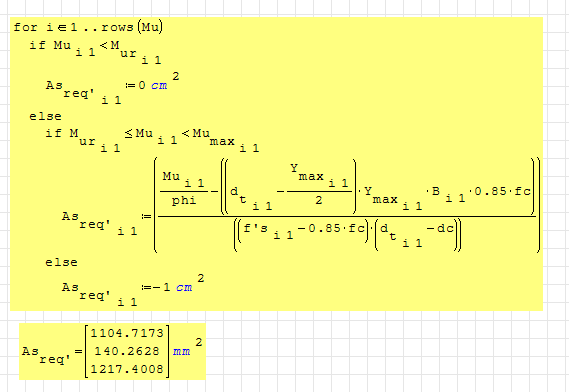

Hi everybody, I have a units problems that I can´t solve. Can be a bug?
Here is my file.
Documento1.sm (29.86 KiB) downloaded 1213 time(s).
Libro2.xlsx (8.17 KiB) downloaded 890 time(s).
Thanks in advance
Eduar

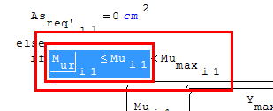

#2 Posted: 8/6/2016 1:42:29 PM
Hello Eduar,
nope, is not a bug; the problem is in your second boolean comparison. You have nested a boolean less or equal in the left argument of a boolean less -> the first returns 0 and 1, then this result is compared with the second argument of the boolean less (and here you were lucky because you got 1 - when you get 0 you can't see the error)
![2016-08-06 18_34_31-SMath Studio Desktop - [Documento1.sm].png](/en-US/files/Download/ATmBGx/2016-08-06-18_34_31-SMath-Studio-Desktop---[Documento1.sm].png)
You have to use the boolean AND to chain two boolean comparisons

Alternatively it is possible to use the function lelt(3) from the plug-in "Custom Functions"

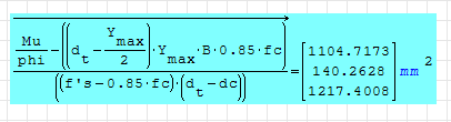

Hi Davide, your method works fine. But I still have problems with the resolution of the division.
I don't understand, the result is a vector.
Sorry for the question, I'm a newbie in Smath.

Don't worry; vectorize() is intended to apply to all the vectors' elements functions normally intended to work with scalars without using loops. In your case you have 2 ways:
1) use the loop; in this case vectorize() is not needed, remove it and everything should works

2) use vectorize(); in this case you have to remove all the references to the matrix elements. Note that in your case you have to pre-process or post-process the elements where Mu doesn't meets the requirements
