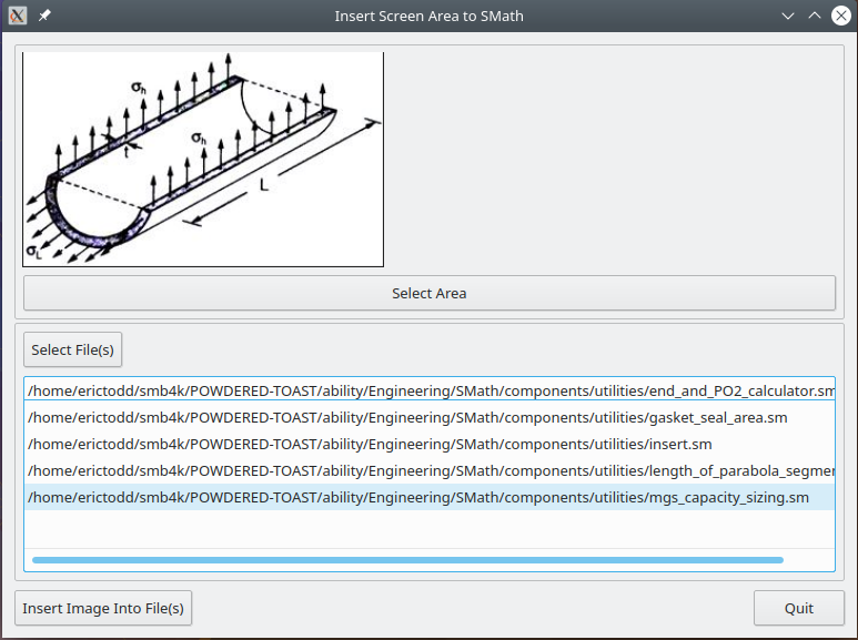

I made a tool to help me with this. It's pretty clunky and will be a little embarassing to share, but it is useful. I'll put it on github, hopefully later today.
#3 Posted: 10/18/2020 12:10:23 AM
Anders or Eric
Anders or Eric
4 likes in 40 posts.
The code for the tool is uploaded to github now. It's a screengrabber-type tool rather than doing anything with what's already on the clipboard. Hopefully it will be helpful.
What I faced when trying to insert images from a file on disk was that they would be invisible then next time I opened the SMath sheet. They've done okay for me when using this method though.
https://github.com/erictmyers/insert_image_to_smath

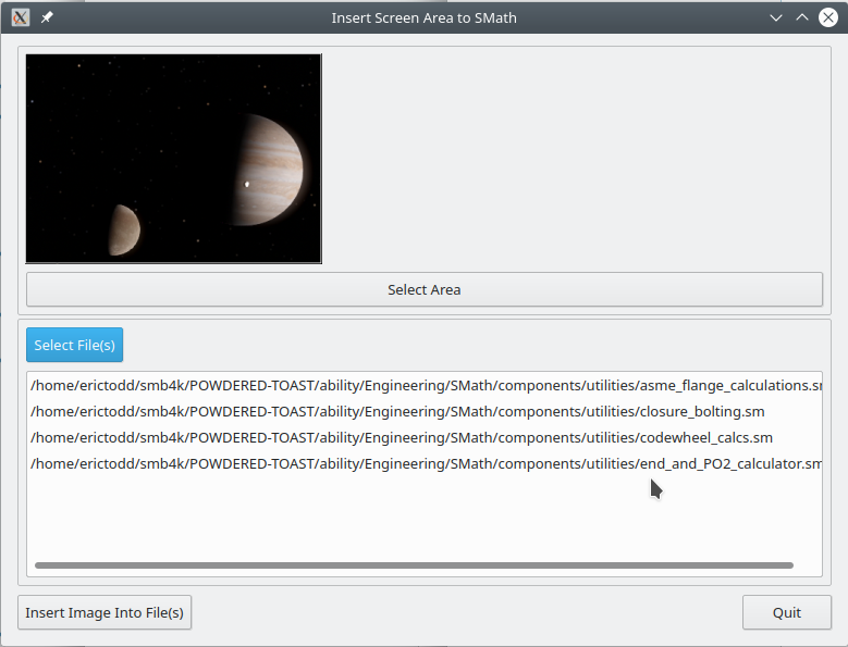

Okay, the new version of the tool is released at https://github.com/erictmyers/insert_image_to_smath.
There is a warning in the README, but I'll add it here as well- the tool writes directly to the selected SMath files. I haven't had any problems with that yet but testing has been minimal, so please make backups before clicking the Insert Image button.

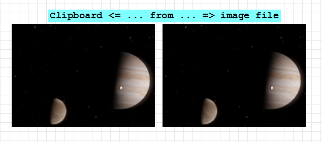

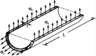

#9 Posted: 10/19/2020 9:02:16 PM
Why insert such a big area ?
Capture/select/crop save [as *.PNG]

Another updated version is available at https://github.com/erictmyers/insert_image_to_smath. It features a much nicer (resizable and movable) area selection, and is cross platform for what that's worth. It requires a newish version of PyQt and Qt (5.10 or higher)
This is the last tweak I plan for now.
#12 Posted: 10/20/2020 8:08:10 PM
Can you just have 10 kB *.PNG instead of 1.3 MB Monster Big ?
#13 Posted: 10/20/2020 8:24:57 PM
Anders or Eric
Anders or Eric
My apologies, I may have been insensitive to bandwidth issues. Hopefully the file size hasn't caused too much trouble for anyone, I'll try to do better in future posts.
